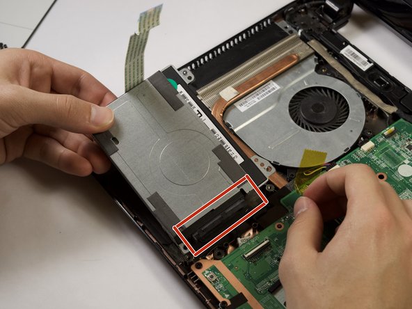

  • Lift up the hard drive slightly and remove the black cable strip connecting the hard drive to the computer
  • Do not lift the hard drive very high, the connector cable is not very long and may get damaged if you pull too far
  • You may need to use some force and wiggling to release it.
