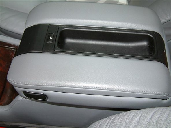

  • Once complete, press and hold the face button (pairing button) on the eject box while turning on the ignition. After 3-5 seconds of turning on the ignition let go of the button to initiate the telephone pairing process
  • From your mobile phone search for Bluetooth devices and select BMW ULF. Use the unique Bluetooth passkey located on the side of the bluetooth module to pair your phone
  • Once complete the system will disconnect from your phone to allow you to connect upto 4 phones at a time with your system. The last phone paired has highest priority
