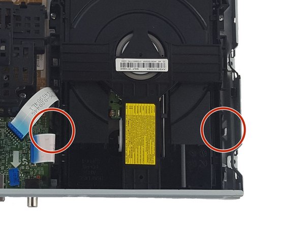

  • Push two small prongs on both sides inwards and push forward.
  • Remove the disk tray.
