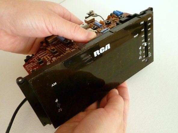

  • Remove the Tinted Digital Display Window:
  • The tinted display window is held in place by tabs on the back of the tinted display window. Two tabs are located at the top and one tab is on the bottom as illustrated.
  • Release the two top tabs and pull the tined display window away from the casing.
