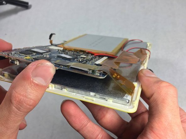

  • Now that the motherboard is disconnected, disconnect the longer flat cables by pushing the locks open and taking the cable out.
