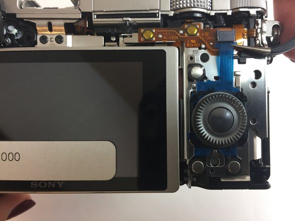

  • Once the back cover is removed, using tweezers, pull to remove the ribbon cable that is holding the settings wheel.
  • Now you can pull the settings wheel out of the camera.
