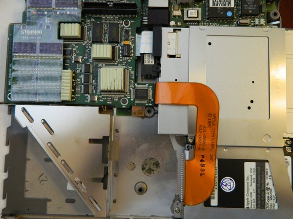

  • Remove the bottom plate by prying up with either a flathead screwdriver or plastic object, such as a credit card.
  • Keep in mind the bottom left and right corners of the PowerBook 180 is very hard to open - you may need to use some extra force to open that side.
  • Your PowerBook 180 should look like the two pictures - with separate top and bottom halves.
