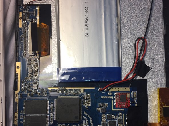

  • Desolder the two black and red wires connected to the motherboard.
  • Unclip and remove the ribbon cables attached to the motherboard.
  • For soldering help, use the How to Solder and Desolder Connections guide.
