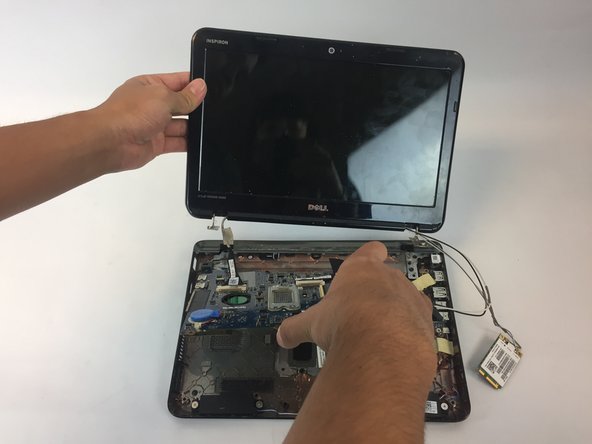

  • While holding screen, remove the motherboard by wiggling it around and pulling outwards.
  • In this step you are trying to pull the motherboard out from the VGA socket it is attached to in the back left corner of the laptop.
