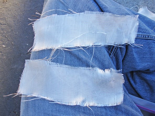

  • When working with fiberglass, be sure to wear the proper protection. Gloves are a recommended minimum. Addition of goggles, a painter's mask and full length clothing will add further protection.
  • Cut out pieces of fiberglass large enough to cover the damaged area and extend at least 1" beyond the repair area. Multiple layers and wider cloth pieces can be used to add strength and rigidity.
