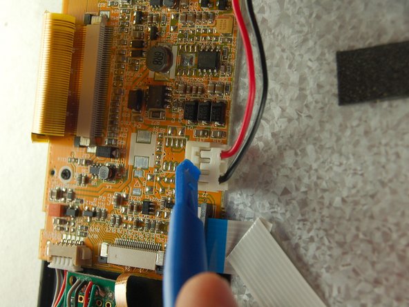

  • Unplug the battery at the plug indicated by the plastic opening tool. (The best way to do this is to place a finger on both sides of the plug and pull out gently) Once you have removed the old battery, plug the new battery into the same plug the old one came from.
