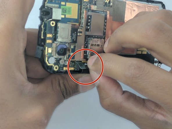

  • First, gently lift the black strip by pulling. It will take a little force and then it will disconnect.
  • Next remove the yellow mylar tape using the precision tweezers.
