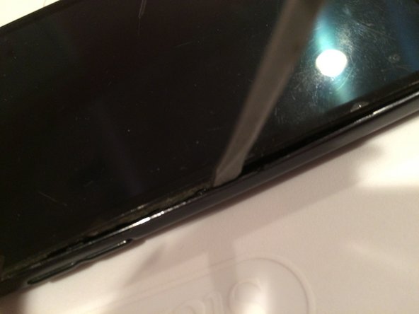

  • Pry the midframe all around the device to carefully remove it
  • If you do not pry throughout the whole device, the midframe will be very hard to remove
  • A plastic tool opener would be better and it will not damage the phone.
