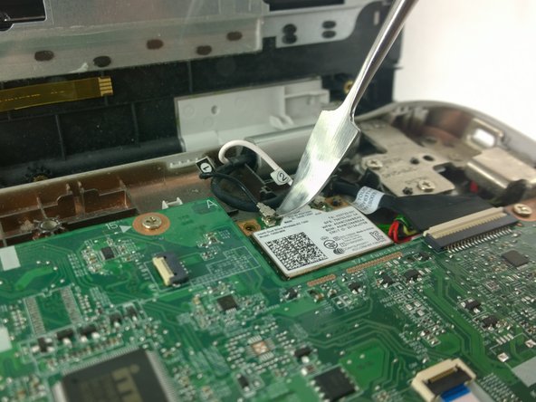

  • Use the spudger to remove the antenna connector attached to the black wire labeled "1".
  • The regular black nylon spudger should be used whenever possible, especially around sensitive internal components.
