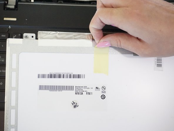

  • Lay the screen down flat on the keyboard.
  • Peel the yellow tape and then the metallic tape holding the screen's connection to the computer.
  • The metallic tape is hidden underneath the yellow tape.
