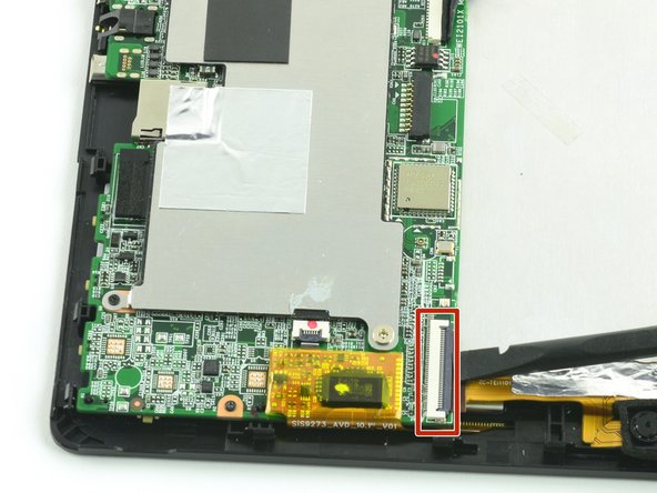

  • Use a spudger to flip up the black flap on the camera's ZIF connector.
  • Pull the ribbon cable straight out of the connector.
