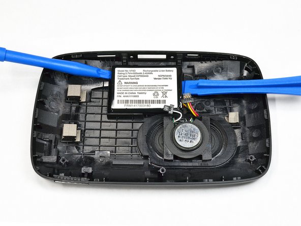

  • Use the plastic opening tools on both sides of the battery to carefully pry it off of the frame.
  • The battery attaches to the frame with double-sided tape so this should be fairly easy to remove.
  • In this image, a smaller plastic tool was used on the left side while a larger one was used on the right side.
