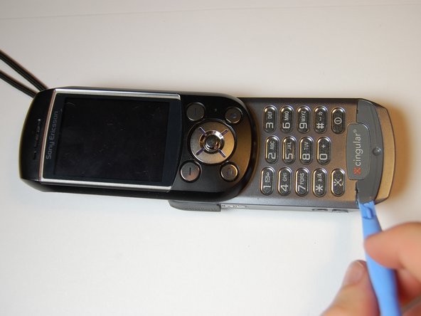

  • Using the iFixit opening tool, pry off the plastic piece at the bottom of the keypad.
  • This piece is fixed with an adhesive, so you must break the bond to reach the screws underneath. It may be necessary to use additional adhesive during reassembly.
