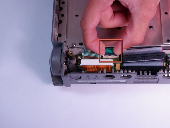

  • Open the right of the two small, white tab fasteners by pulling up on both sides.
  • Remove the green and silver ribbon cable from the tab fastener.
