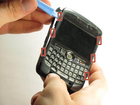

  • Use a plastic opening tool to detach the securing clips holding the the front panel in place.
  • There are six securing clips total.
