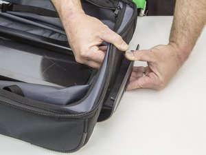

      Open the zip inside the trolley to expose the handle.
      crwdns2936071:02crwdne2936071:0
      Unscrew the two screws in the lower section on the handle assembly using a Phillips screwdriver.

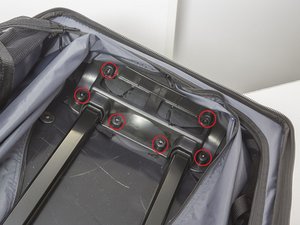

      Using a Phillips screwdriver, unscrew the 6 marked screws attaching the handle to the upper section.
      crwdns2936071:04crwdne2936071:0
      After unscrewing all screws, it is easy to remove the entire handle assembly.
