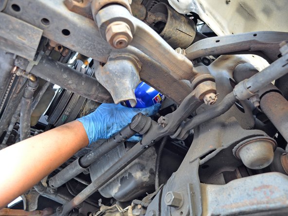

  • Place the threaded end of the oil filter onto the engine's oil filter threads, being careful to not get dirt or debris on the filter's gasket.
  • Turn the filter clockwise by hand until it is snug.
  • If the filter is difficult to turn at the beginning of its threads, stop! You may be cross threading the oil filter. Re-align the oil filter and try again.
  • Do not over-tighten your oil filter by using a wrench. Doing so may cause the oil filter seal to leak and will make removing the oil filter very difficult in the future.
  • Remove the oil drain pan from underneath the truck.
