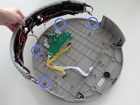

Place the New Bumper
  • Now line up bObi Pet’s new bumper with the corresponding screw posts on her lid.
  • Make sure the sensor strips slide in behind the screw posts on both ends of the bumper.
