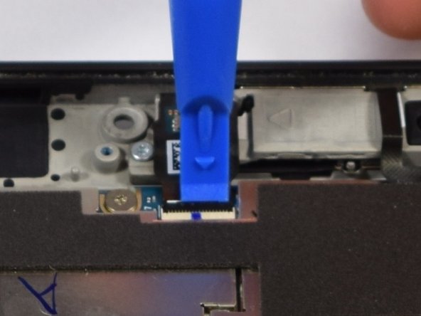

  • Locate the third clip at the top center of the device, up from the first battery connector.
  • Follow the same procedure from the last step.
  • Lift up the black flap and pull out to release the flex cable.
