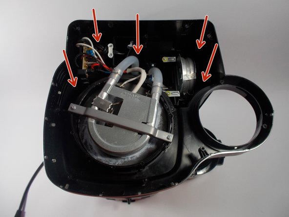

Hamilton Beach 49980A Main Housing Replacement

  • Use a long screwdriver with the PH1 bit to access the screws holding the main housing to the top of the machine.
  • Pull main housing up and be sure to run all of the inner parts through the cavity at the bottom. This may take a few tries since components can easily get caught on each other
