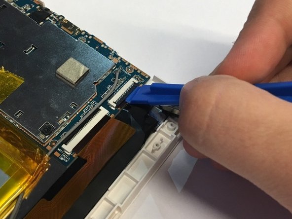

  • Using a plastic opening tool, lift up the latch that attaches the camera's ribbon cable to the device.
  • Using tweezers, pull out the ribbon cable from underneath the latch.
