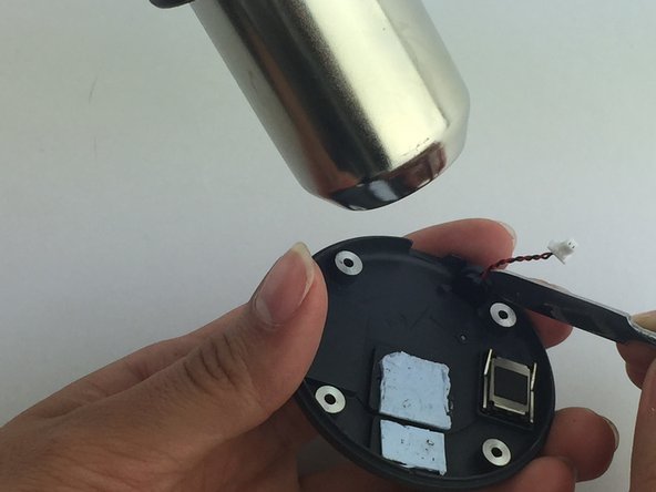

  • Holding the back panel firmly, use a spudger to pry off the small plastic panel holding the mic cable in place.
  • Use a heat gun to melt the glue keeping the mic cable in place and then remove it.
  • During reassembly this plastic piece may need to be glued back on to ensure the mic cable stays in place on the back panel.
