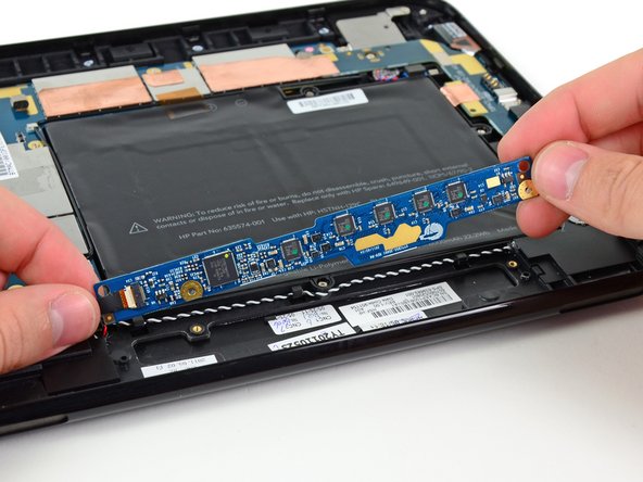

  • Lift, but do not remove, the digitizer control board out of the rear case.
  • Do not try to completely remove the digitizer control board yet, as it still remains connected to the motherboard by the digitizer control board ribbon cable.
