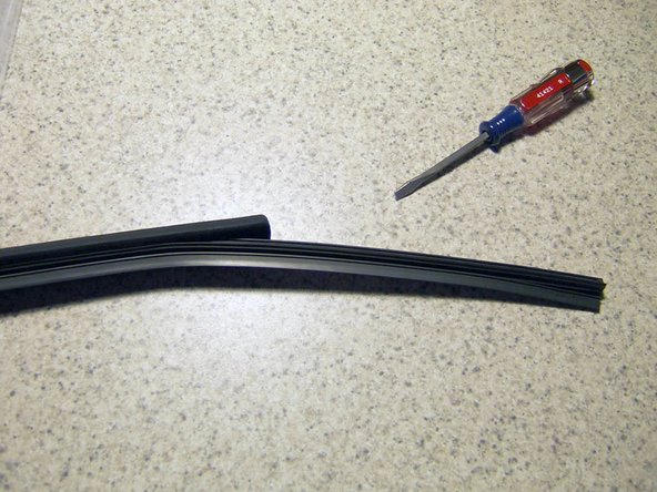

  • The insert should now slide out smoothly. Do not try to lift it out, but gently slide it out from the end of the blade.
  • As you slide it out, you will see the splines (one on each side) coming free. Try to keep those in the insert until it's about 50% removed. You can then slide them out -- carefully! -- and set them aside.
  • Try not to drop the splines or otherwise damage them. They are not sold separately.
  • Since you have the blade insert fully removed, now's a good time to clean the wiper blades, inside and out. I like using a small interior detailing brush in the slot and brackets, but an old soft toothbrush will suffice.
