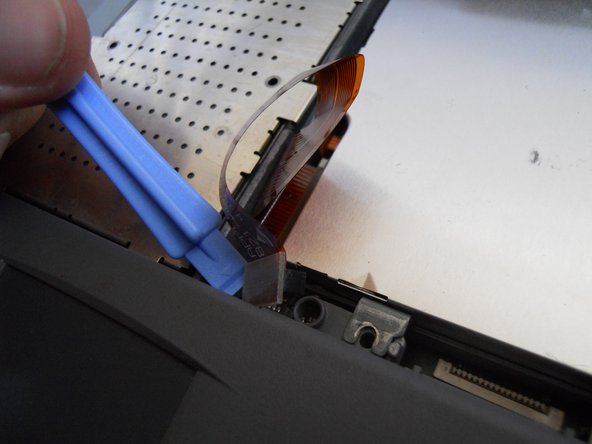

  • Using a spudger, lift the plastic tabs on the floppy drive securing the ribbon cable to the ribbon port.
