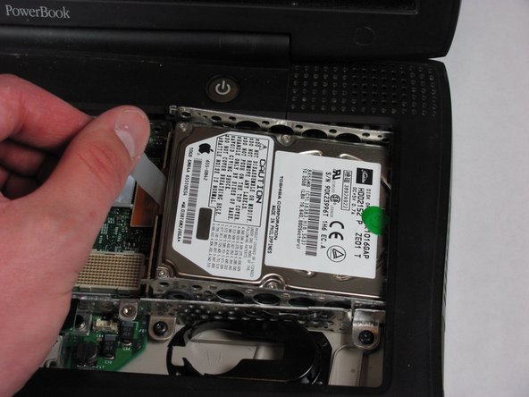

  • Grab the plastic strip shown here and gently remove, pulling up and left.
  • Pull left to avoid the hard drive catching the casing.
