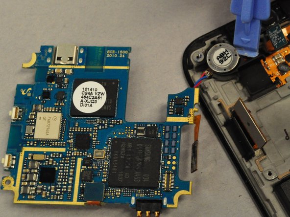

  • Using the plastic opening tool, gently pry the silver cylinder out of its housing.
  • The cylinder is held in place by a weak adhesive and shouldn't be too difficult to remove.
