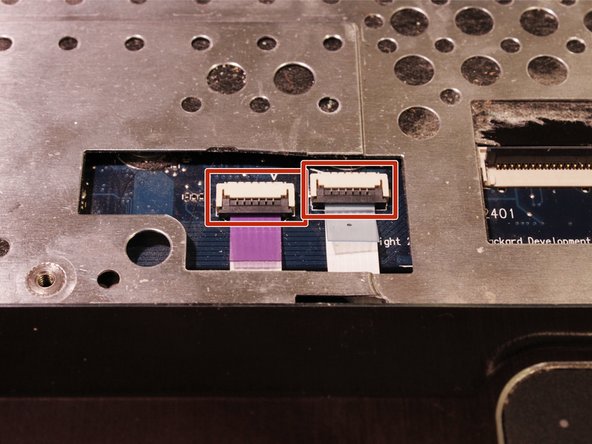

  • Turn computer over and open the computer as far as possible without breaking it.
  • Release 2 ZIF connectors where the touch pad cable and fingerprint reader are connected.
  • Remove 4 Phillips M2.0X4.0 screws near the top of the keyboard area.
