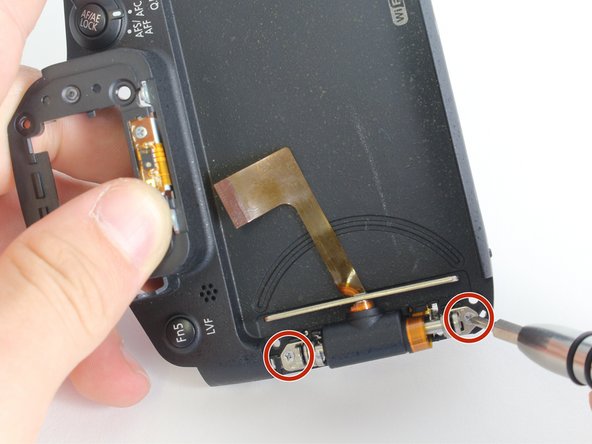

  • Remove the two 6.3 mm Phillips #000 screws from the outside of the screen axle.
  • Pull off the screen axle.
