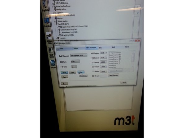

  • Next to that will be the Cash Dispenser tab. Under the Cash Dispenser drop down menu, click on “Bill Dispenser F400”.
  • In the COM Port drop down menu click on COM2 and select 5 from the # of Cans drop down menu.
  • The denominations should be as follows (4 will probably need to be changed after set up.)
  • CC0 Denom: $1.00
  • CC1 Denom: $5.00
  • CC2 Denom: $20.00
  • CC3 Denom: $20.00
  • CC4 Denom: $20.00
