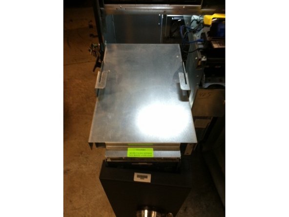

Remove the Cover
  • The next place to check is the top of the dispenser at the head. Sometimes you will need to remove a cover to the dispenser and the two plates that keep it from swaying too much.
  • Make sure all the belts are there and intact. If the middle is missing the machine can potentially still function but it won’t be reliable. However, if either of the side belts are missing the machine will not function properly at all and the entire head will need replaced.
  • If the belts are twisted the best thing to do is to untwist one section and slowly turn the dispenser knob, holding that part of the belt in the correct position, until it’s untwisted in its entirety.
