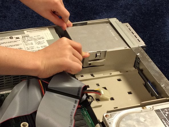

  • To gain better access to the power supply, push the two tabs securing the floppy drive out and slide the floppy drive forward a few inches.
  • If you have a CD-ROM drive installed in the Mac, disconnect the SCSI ribbon cable, the CD-ROM power supply cable, and the CD-ROM audio cable. Remove the EMI shield in the front of the CD-ROM drive also.
