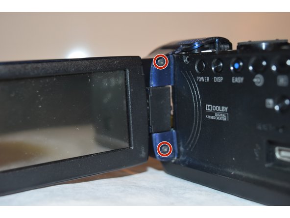

  • Using the Phillips #000 screwdriver, remove the two 3mm screws from the LCD Screen connector.
  • Remove the two 3mm screws that were exposed through the previous image
  • Carefully detach the LCD Screen from the rest of the camera.
