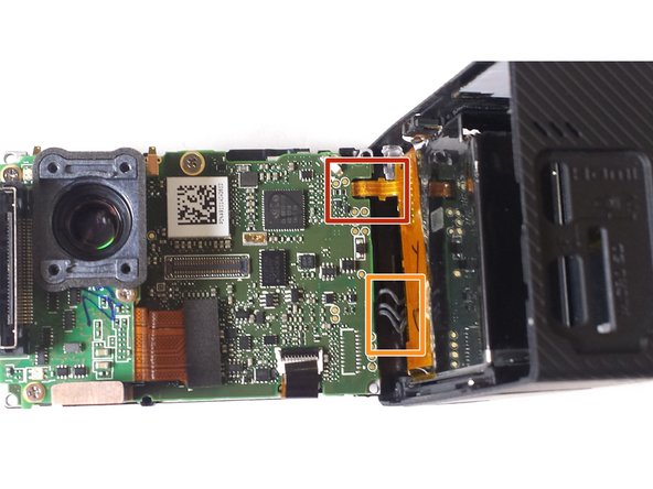

  • Remove the ribbon strip by pulling on it. This will remove the connection.
  • Push down on the three wires and the clip will disconnect from the motherboard.
  • During reassembly, remove the black tape on the ribbon cable, turn the camera upside down so you can see the port, and reinsert the cable with tweezers. It's a lot easier!
