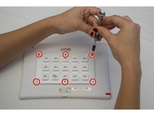

  • Remove the six 2.5 mm JIS #000 screws attaching the custom grid to the back panel.
