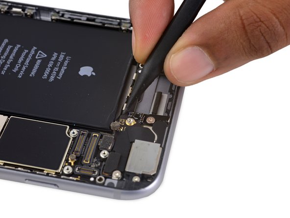

  • Use the pointed end of a spudger to gently nudge the top left antenna cable out from under the rightmost clip on the logic board.
