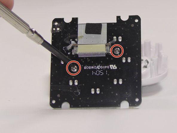

  • Using a Phillips #2 screwdriver, remove the two 6.0 mm Phillips screws that hold the camera lens on.
  • These two screws have a different thread than the four screws that secure the camera unit's housing.
