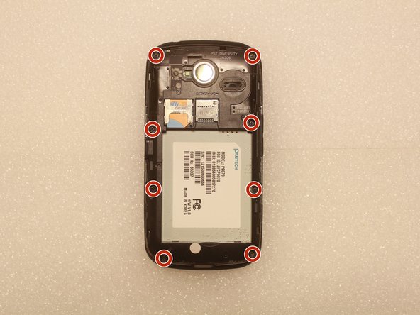

  • Undo all 8 visible screws using a phillips size 000 screwdriver.
  • The screws are marked in red on the picture.
