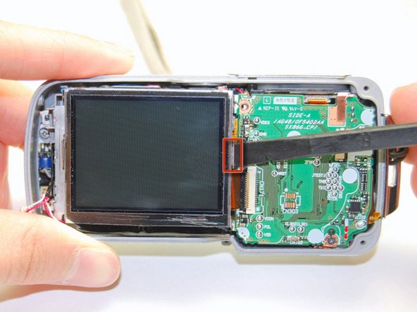

  • Remove the LCD screen from the camera by inserting the spudger between the screen and the metal hook on the right side of the screen and prying up gently.
  • Flip open the black gate holding the copper ribbon from the LCD screen.
