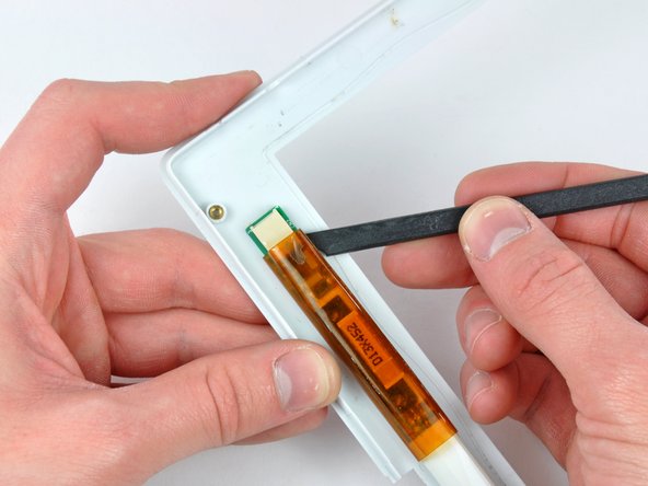

  • Insert the flat end of a spudger between the display inverter and the front display bezel near the center of the inverter.
  • Run the spudger along the length of the display inverter, separating it from the adhesive securing it to the front display bezel.
  • Lift the inverter out of the front display bezel.
