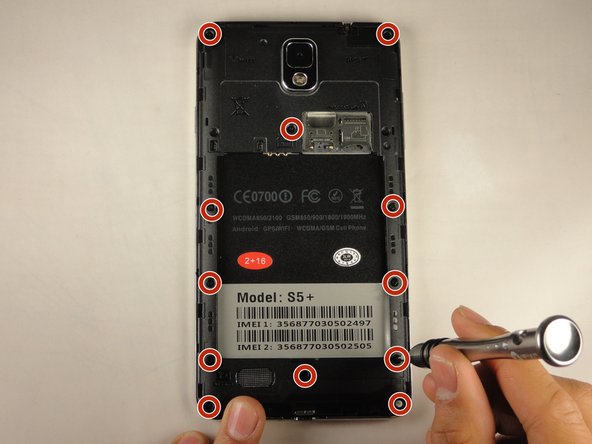

  • Unscrew the twelve 3 mm screws from the back panel using a Phillips #00 screwdriver.
  • Keep these screws in a safe place. They are very small and easy to lose.
