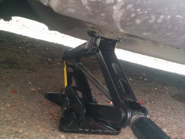

Raise the vehicle.
  • Place the jack at the jacking point and slowly raise the vehicle.
  • Once the tire is off the ground, find a secure spot to place the jack stand. Make sure it is a spot that can hold the weight of the car. The pinch joint under the door can hold the car.
  • Gently lower the car onto the stand.
  • Test the car's stability on the stand by pushing it back and forth. DO NOT take the wheel off or go under the car until you are absolutely sure it is secure.
