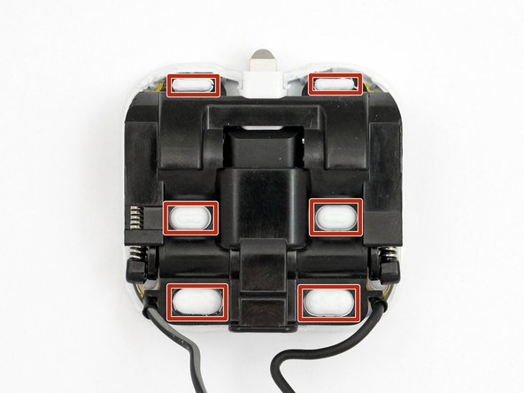

  • Most of the mechanism is covered with a hood, fixed at points using thermoplastic staking during production.
  • The only way to remove the cover is to cut the tops off these.
