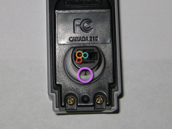

Nintendo WaveBird Wireless Controller Receiver Teardown, Controller pinout: crwdns2935265:00crwdnd2935265:01crwdnd2935265:01crwdne2935265:0
Controller pinout
  • Red: 3.43V logic supply (pin 1 on cable)
  • Brown: Ground (pin 3 on cable)
  • Green: Data (pin 2 on cable, recessed by 2mm into connector)
  • Violet: Shield (pin 4 on cable)
