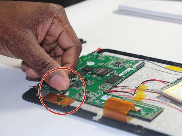

  • Remove the small ribbon cable from the socket that attaches it to the motherboard.
  • Flip the dark grey latch to release the ribbon cable from the motherboard.
